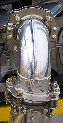

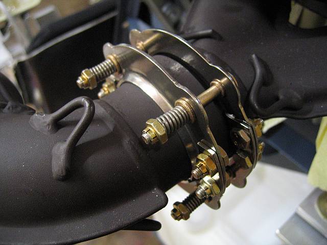

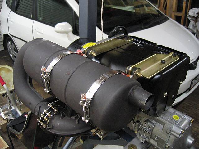

Ja I hate it when I do that. Here are examples of two different types - I like the idea without springs.
Exhaust Clamps 2.jpg (63.35 KiB) Viewed 2622 times
Exhaust Clamps 3.jpg (45.58 KiB) Viewed 2621 times

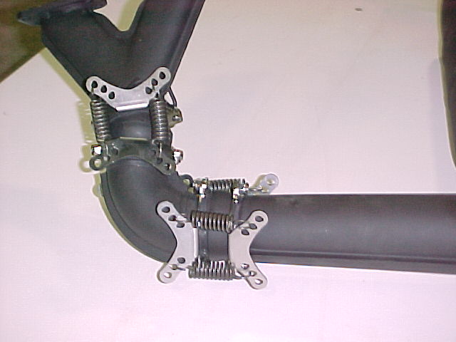

Other type.

Cloud Warrior wrote:Has anybody in SA fitted these exhaust brackets instead of springs? Any feedback on how will they work (or don't). Thanks.
Hi CW,
I like the flanged one. Never seen them in SA though.
But with 100 hours usable life and safety wire in terms of the current spring set-up, I personally don't see a need for change.
For info, the black colour on the exhaust is from using a 50/50 mix of raw linseed oil and mineral turpentine – painted on while the exhaust is still very hot. :idea:

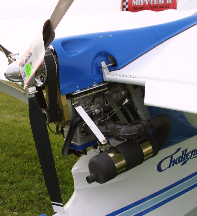

Found this example as well - bit more "agricultural"...........
Solowings Aquilla
32-4817
Cloud Warrior
Posts: 558

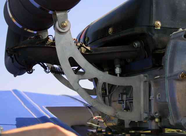

Postby Cloud Warrior » Wed Jan 23, 2008 1:12 am
Another one - on a Challenger nogal. Looks like a nice and simple mounting.
Solowings Aquilla

Postby Tobie » Thu Jan 24, 2008 9:58 am
I also thought it was neat and simple, and yes anything can be engineered or reverse engineered but as Cloud Warrior mentioned it sometimes work out more expensive not mentioning the time taken to reverse engineer something sometimes. Thats why one weighs it up, comparing the price to a self engineered item.
Thanks for the other pics Sebastian, they all help.
