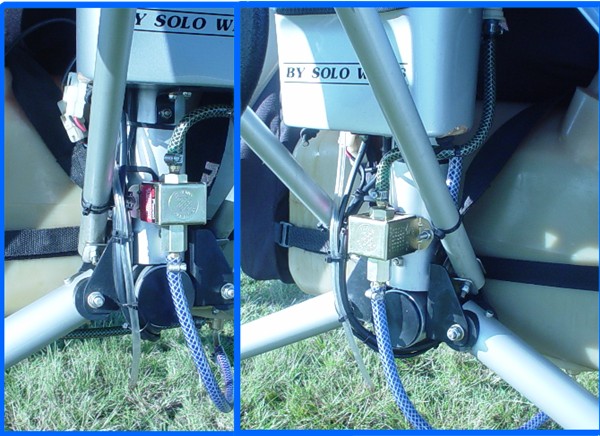

I have recently purchased a Airborne Classic 582 having spent most of life flying 3 axis. (with fuel pumps) Does anyone have any info on fitting a additional electric fuel pump to the trike . Any suggestions would be appreciated

If you go this route, ensure that the facet pump doesn’t deliver more than 3 psi.
John ZU-CIB
Inline facet fuel pump
