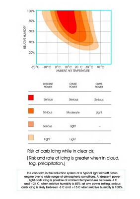

Thought that this would be most useful for most of you.
