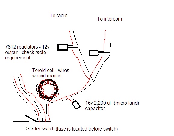

Hi andreb,
There have been a couple of posts about the RF Choke - here'e one -
viewtopic.php?t=1135&highlight=choke
1. Toroid coil (approx 40mm diameter) - cost R 45 (or ask a Ham Radio mate to find you one for free).
2. 2 X 12v voltage regulators - cost R 4 each. Ensure that the radio requires 12v and not 11v)
3. 1 X 16v 2,200 uF (micro fared) capacitor - cost R 2.
4. 2 X small electrical boxes (one to house the toroid and the other to house the voltage regulators) - cost R 4 each.
5. 1 metre of 6 amp twin power cable (red & black - approx 3mm in diameter) - cost R 3
6. Grommets for the wiring.
The circuit is simple. Connect to ignition switch (the fuse is normally located between the battery and the ignition switch, meaning that the circuit is already protected). Wind power cord around the toroid about 20 times and fit the capacitor in parrallel after the toroid winding. Split the power cord into two and route each through a voltage regulator. Connect each of the two cords to the power jacks normally provided on the instrument pod for the radio and intercom.
John ZU-CIB

The components are: -Morph wrote:The entire lot cost me R70 and it works like a dream.

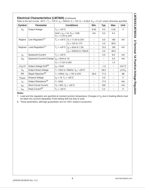

- ZULU1
- Posts: 1339
Use a LM317
Yes you can use LM 7809 in a TO 220 package or a LM317 as its adjustable or if you require 5 amps use a LM338 also available with a TO220 package. I pay about R9.00 each for them.
I manufacture them built up with a line choke and adjustable regulator.
Alternatively Google "LM 317" and you can download the pdf drawing from the web.
Zulu 1
Zulu 1

Howdy ZULU1,ZULU1 wrote:Secondly the radio is susceptible to rf ingress in the power supply (talk to Massimo!) we fix this with a line choke (not a torroid as the frequencies are totally out) and a rf bead on the incomer. It works. The capacitor advised just helps line induced noise an not rf. The best bead to use is the Icom unit supplied with the charger.
You state that the revs rise, you are receiving a reflected power from your antenna as the SWR is haywire, probably caused by a poor connection, back to the rec counter ,this compounded with the fact that the Vertex does deliver a true 1,5 watts
The toroid coil when wound is indeed a very effective RF Choke.
The capacitor is parallel to absorb any ripple that might get through.
Doubt that the SWR at 1.5 watts is responsible for the "turbocharged rev counter".
John ZU-CIB

Simple actually, uninstall Buzzcom, send Vertex radio to Paul, he sends back with mods, new V antenna (on Kingpost), new comms box and headset.
Result is top quality tramsmission and communicatio, with no interference and background noise. I have to keep checking that I am transmitting and people can hear me....that is how quiet it is.
ALL SORTED OUT PAUL. THANK YOU.
Another Happy Customer
PS - The rev counter doesnt move a mm when I transmit!!
