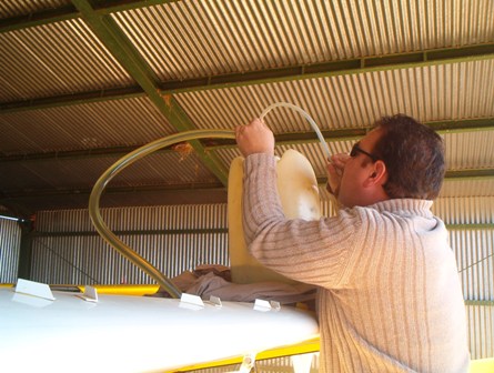

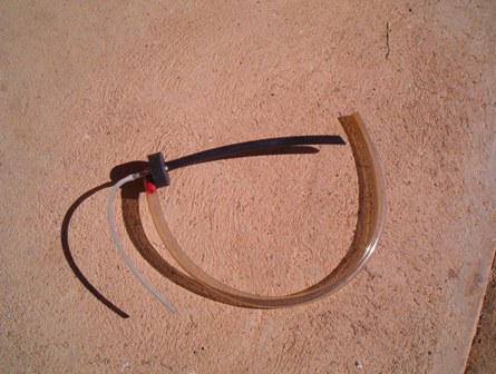

Hi :!: I am making this patent for transferring petrol. I call my device the "Blow job"......no really. You push down on the rubber part, and blow in the thin pipe. The benifit of this device is that you can start syphoning easy with a 1/4 full 25Lit can. Or even less. Also runs very quick. 25 lit less than 2 min. :D

Pressurising the container. Good idea Boet !!!!

Pilot at Cato with back problems used this device.
Postby John Young » Tue Jul 10, 2007 6:14 am
Pilot at Cato with back problems uses this device.
Fitted a small compressor and can get the fuel into the tank without having to lift the jerry can.

Boet how do you stop the fuel flow when you only need to top up the tank and still have a lot left in the container? :roll:

Postby RV4ker (RIP) » Tue Jul 10, 2007 10:15 pm
Block pipe with finger and lift pipe above the level in container. It flows back into the container and you have fuel on finger as opposed to in mouth.... :wink:
