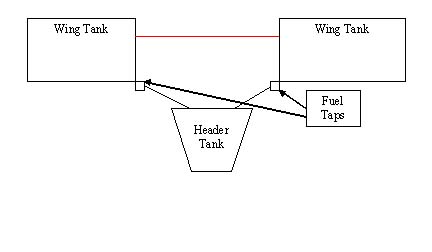

Postby Morph » Sat Jun 30, 2007 10:00 pm
Bennie, having the header tank is creating a t-piece between the two tanks. See attached pics.
The red line is the line you want to put in. However if both taps are open then there already is a T between the tanks via the header tank. If the plane is standing level and you open both taps the fuel levels will equalise.
I too like the idea of see though tube just from the tap to the header tank. Gr8-dad has these. The only thing is when you first switch open the tap you will notice some air bubbles going down the tube. If you see this is the air you get a bit of a skrik. However the header tank traps the air and ensure just fuel goes to the motor.
