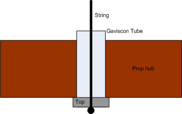

Bennie,
I balanced it myself. The secret is to get the two blades exactly the same weight.
My prop had a 25mm hole through the centre. I found a Gaviscon Tablet tube had exactly the same dimension. I drilled a 1.5mm hole dead centre in the plastic top and bottom of the tube. I tied a knot in a piece of string and fed it though the plastic top, then into the tube and out the small hole in the bottom. I then inserted the tube into the hole in the centre of the prop hub from the front, i.e. the side of the blade that is curved faces the platic proppie(top) of the tube. This is important.
Now find a place where there is no wind draft and hang the prop from a light, or the ceiling, or a ladder etc. (the back of the prop blades i.e. the flat end) should be facing up.
Leave it to settle down and one of the two blades will hang lower (it's heavier) than the other. Using a simple aerosol can of clear lacquer(fast drying), spray a bit of on the back tip of the lighter (i.e. higher) blade and allow to dry. Work slowly and allow the prop the settle down between spraying. Eventually the prop will hang perfectly level. Use something like a window sill as a indicator as to what level is. I managed to iron out over 90 % of the prop vibrations like this.
if the gaviscon tube doesn't fit measure the hole, go to the pharmacy and see if they have any tablet tubes that fit.
BTW this will work for any prop

Postby Morph » Wed May 30, 2007 10:44 am
Oh yes, vitally important, when you put the prop back on, make sure it is tracking perfectly. Make sure the prop bolts are torqued correctly. Then use a broomstick or a dowel stick and attach it to a ladder or chair etc or to some point on the airframe. Turn the blade being measured horisontal and position the stick against the tip of the prop. Now rotate the prop without moving the stick and compare the next blade. They must all be exactly the same. If one is out use a shim (I found a small piece of broken hacksaw blade placed between the prop and the hub works perfectly, the teeth bite into the wood and it will not come out). Otherwise you will have to remove the bolts and put a washer on the relevant bolt. Tighten all the bolts up to the correct torque settings and check again.
