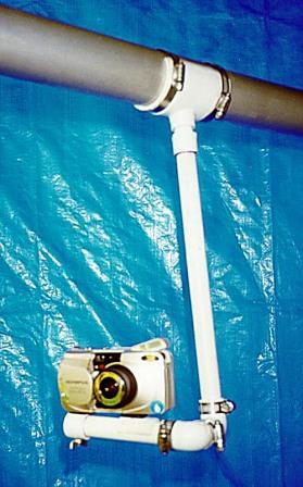

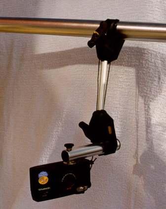

I am using bullet type cameras on my trike and I have made use of mostly RAM Mount components for my setup.
There are some "made for purpose" mounts out there as well as home made jobs - see below.

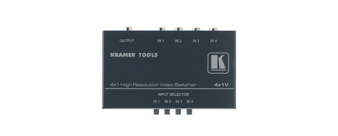

Hi Walter
You can buy a relatively cheap switcher at the nearest Dick Smith or you can go upmarket with a better quality device like this one.
