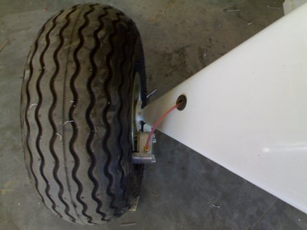

Have seen these at on some or other type of fox.
- 100_1064.jpg (61.45 KiB) Viewed 2511 times

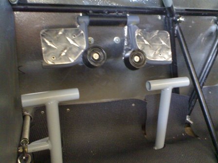

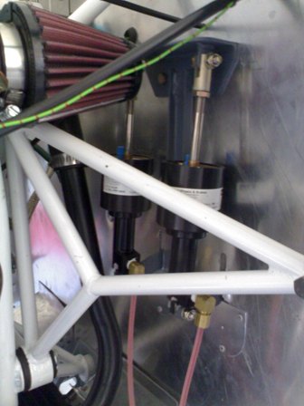

The manufacturer was very gracious in admitting the mistake made, and replaced ALL affected master cyl`s free of charge. I must add that the replacements has been slightly altered, and works MUCH better. Now world class. To get to the BB`s brake system. Hydraulic. The hydraulic system that I use can hold the BB at FULL POWER. I have however found it nessecary to modify Monty`s pedals slightly. ( Sorry Monty :D ) See fhodie attached. Both the master cyl`s and the slave cyl / wheel assy is manufactured locally, and is of outstanding quality. The only downside, like I remarked, is the TIME it takes to get hold of the stuff. The systems is made in different locations by different manufacturors.
Refer to the pic of the Master cyl fitment. To make your brake system dual, you need two extra master cyl`s, fit them to the right hand side, and "T" the brake lines into the left and right brake lines. Sound simple? Right?...... Wrong
Entails a bit of welding for witch it would be wise to remove the engine. Firewall and all.
It would be wise to decide exactly WHAT you want brakes-wise, while still assembling the aerie.
Note also that the TOP of the master cyl`s are anchored to the firewall, and when you apply brakes, the whole BODY of the slave cyl`s moves up when braking is applied. The brake lines I buy from Hyflo, 4mm hard, white nylon tubing with a 6 bar rating. Easy to install, wirks fine, you can SEE air bubbles in it, and the price is right.

- Brake system 3.jpg (23.09 KiB) Viewed 2437 times
- Brake MC `s a.jpg (30.77 KiB) Viewed 2437 times
