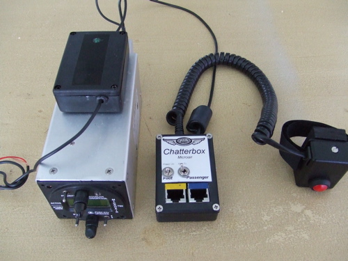

We have just designed and manufacture a replacement for the TT 2000, this is to be sold in the Oz market for the same problem that you advise. Also turn the power down on that unit to 1 watt as they are standard at 5 watts. I have done a few now and it improves them some what. Then should you have problems with the intercom balance (this by the way is guaranteed) call me and I have a fix for that also..and you will pick up power derived noise from the plane, I have a fix for that also..
Our antennas are made in cast ally and not PVC, the dipoles are fibreglass and sourced from our ski boat friends..they also prevent the rf ingress derived from the GPS 296 and others. They will also fit the Aquilla and other trikes, ideal for ships with pods. I have spent a few hours on this particular installation..

Microair
Hi All
The microair is designed for closed cockpit, they are a mission to balance for open usage as the two adjustments Mic gain and side tone are difficult to achieve.
They are standard with 5 watts.
To allow them to operate (and they do work well) I do the following:
Use the standard 4 wire connection from the Microair and disable the side tone in the chatterbox when the PTT is pressed, this prevents any ingress from the radio itself side tone.
I generate a "pseudo" side tone from the intercom so only the voice is transmitted out. The mic gain is no longer confused and allows clear transmission out.
I reduce the power (remove small sticker on lefte hand side) this is marked Microair inpection only.. turn to 1 watt.
I then add in our line chokes and regulators to prevent noise entering the cable network.
The nett result is it performs very well.
Pictures of the new antenna to follow as they are still very very new and expect to pay ex works about ZAR450,00.
eish Zulu1
eish Zulu1
- Microair.jpg (89.79 KiB) Viewed 2110 times
