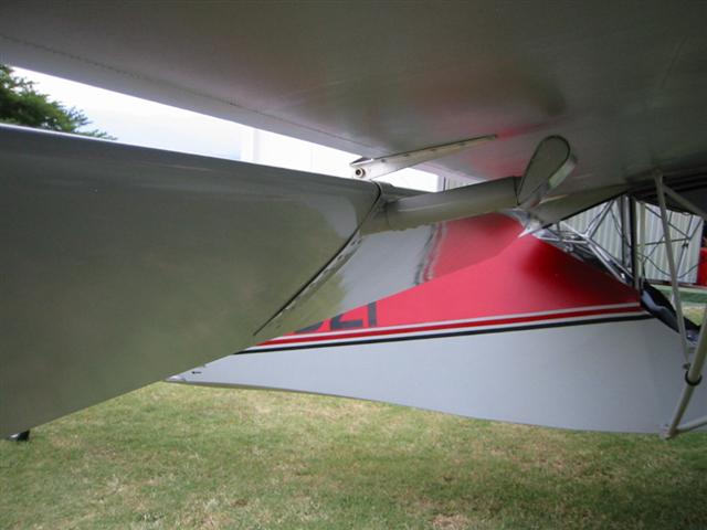

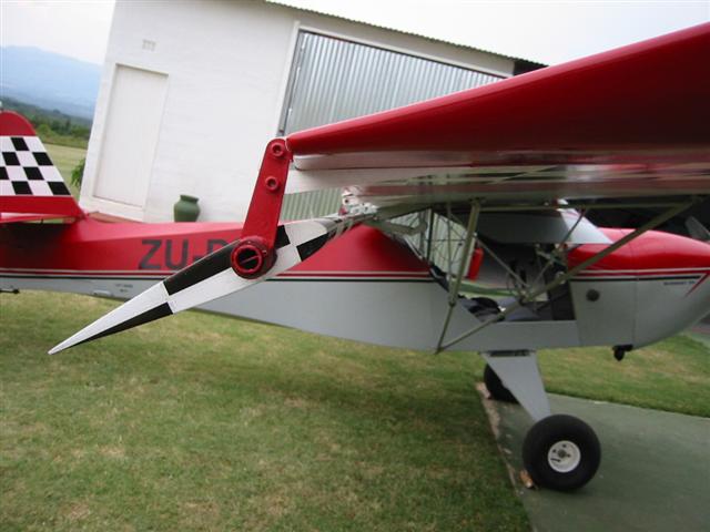

Further to what Justin says, I have modified my flaperon system in the following way to make it safer, more user friendly and to fully utilize the STOL capability of the tail dragger BB.
I also did not like the way the flap handle sits close to the floor when flaps up so I cut it just past where it crosses the torque tube between the joysticks. Then I bent a nice goose neck out of the same grade of steel tube and welded it on, Now the flap handle is right near where I need it, just below my throttle control and I don't have to fumble around for it on the floor.
To give me more flap travel and also have aleron travel at full flap I have modified the horn balance on each aleron as follows. First I made aerodynamic shapes out of some flat steel sheet then welded a short piece of pipe on each. these pieces of pipe are angled to give the same angle of incidence as the flaperon. Then I filled these with molten lead. The finished product is about 1/3 heavier than the standard hammers that come with the kit. Next I cut the arms on the flaperons much shorter, used some aluminium pipe of a slightly larger diameter than the arm and trimmed it down till I got the flaperons balanced IAW the manual.
I then adjusted my up elevator travel to max to assure elevator authority on roundout.
The end result is 23degrees of flap with full aleron travel and my plane stalls at 25 kts full flap at max weight 500kgs.
I am not able to give you any measurements as I am not near my plane at the moment.
Here are 2 pics of the system.
Full left aleron at full flap.
IMG_0279 (Small).JPG (36.08 KiB) Viewed 1236 times
Alerons neutral, 23 deg flap.
IMG_0278 (Small).JPG (44.88 KiB) Viewed 1236 times
