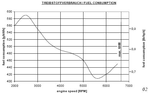

I've got a 4:1 gearbox and a 582. At cruise one up @ 55mph rpm sits at 4000 (1000 prop rpm-very quiet), two up about 4300. The max she gets is 5900 rpm @ 90mph bar in, if I floor it (6000 MAX), she starts climbing at 90.
Now here's the predicament. Manual says max rpm on ground is 5500rpm. I pitched to that. The manual also says MAX Prop rpm is 1625 (x4 = 6500). But I can't seem to reach 6500? Should I reptich so that at 90mph I do 6400ish? This would push up my cruise etc. Remember it's a 4:1 gearbox so ample torque.

Also I've got the fuel consumption graph from the Rotax manual but I think I'm misinterpreting it. What should best cruise rpm be?

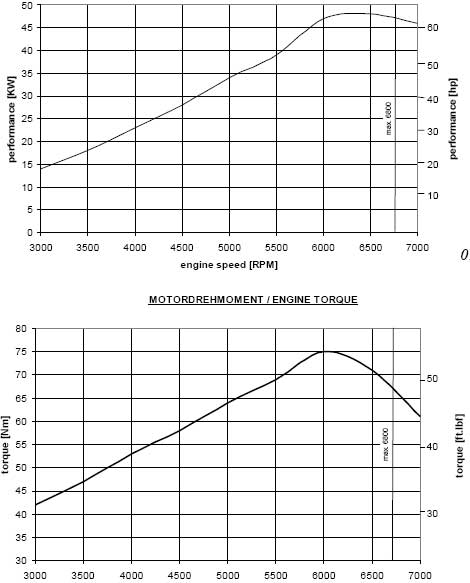

Looking at the Dyno graph, I'm running the motor under it's power band?

I had a similar set up. Aerotrike Safari, 582, E-box with 4:1 ratio. Bought the aerie with 6 blade Ivo prop. I never really flew this prop, and replaced it with a 3 blade 72" NC prop. I can't remember the exact pitch, but it was around 25 to 27 degrees. Static run-up gave me 6,400 rpm, and would see 6,800 on climb out. Cruise, one up around 5,000 rpm, and 5,400 two up at Highveld altitude.
From what you are describing, you are not running your 582 anywhere near optimum, and most likely it is due to the prop pitched to course.
Reduce a degree at a time until you see around 6,400 on static run up. Don't make the mistake of thinking that you are saving fuel or running better at low revs. Two strokes are designed to perform at their peak at high rpm. Rotax specifies 6,800 for max 3 minutes and 6,500 max continuous on this engine if memory serves me right.
