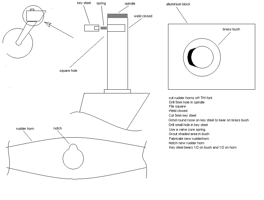

For the Bushbaby builders who want a break away tailwheel, modify that standard one, takes just a couple of hours.
- Breaking TW.GIF (9.63 KiB) Viewed 2488 times
