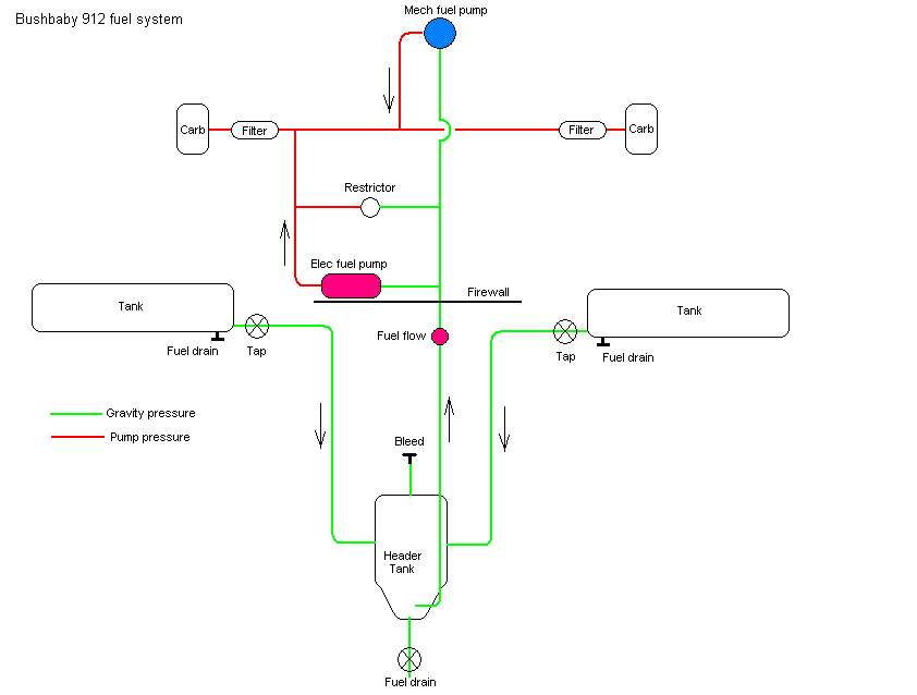

This reply also in response to a pm from Morph regarding the routing for the return line. It is the same layout I have used for all my microlights and homebuilds and works for me.

OK,
This setup will still give you accurate fuel usage readings through the fuel flow.
So all you are doing is providing a return line via the carb side of the pump, via a restrictor to the tank side of the pump.. What exactly does this achieve?
Secondly, you have an electric fuel pump. Does this pump have a one-way valve in it? Otherwise fuel will push back through it instead of the restrictor
Where does one get a restrictor
Mogas
Posts: 882
Location: Nelspruit
Postby Mogas » Sun Jan 28, 2007 2:10 pm
The restrictor allows excess fuel pressure to return to the line and not try to overcome the float levels in the carbs.
I can not tell you what size my restrictor is unless I strip the system. My restrictor came with the 2nd hand engine I bought. I recall it looks home-made, about the size of a main jet, made out of a piece of drilled brass pushed into the restrictor line. I suppose the size will depend on your pump output.
Yes, the electric pump I have also has a one-way valve. BTW, this pump is purely used for priming the carbs if required and as a standby pressure source. I normally have no use for it in flight even for takeoff and landing, emergency use only. In a normal situation gravity feed from the tanks would be sufficient if the mechanical pump packed up, provided filters were not restricted.
Do you have a means of measuring the fuel pressure? if so you could experiment on the restrictor size to get the correct pressure at your carbs.
Hope this helps.

Postby Morph » Mon Jan 29, 2007 9:46 am
Only one change I would make here, I would put the filter before the Fual pumps, to stop any crud from going through them

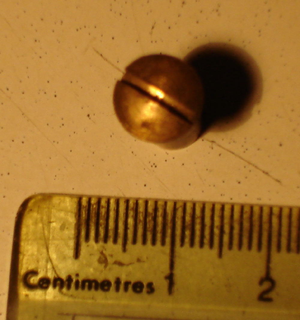

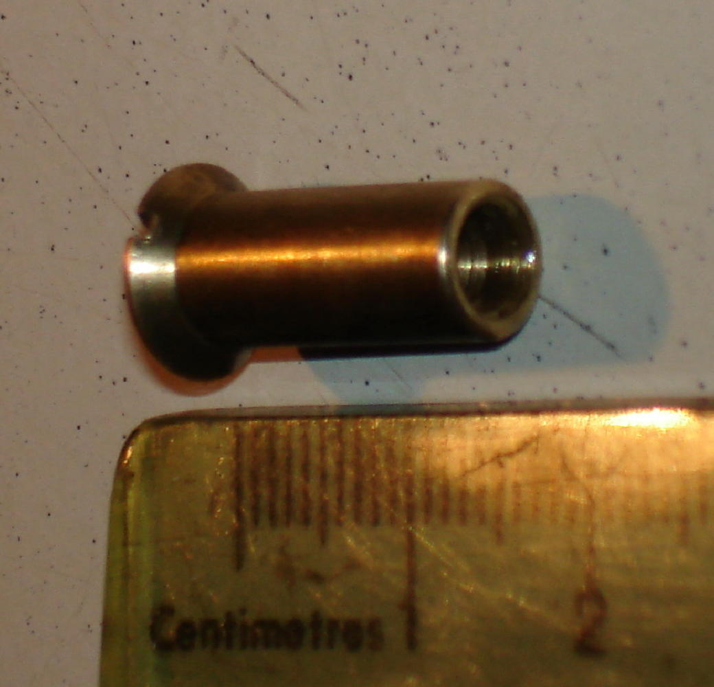

when I needed a restrictor, I scratched around in my collection of odd nuts and bolts, and found some brass "screws" with a head for a flat screw driver, a smooth hollow shaft with a thread inside. I can't recall where these screws come from, possibly stripped out of some electrical component. They cannot be too scarce, as I had a couple of them. The diameter of the shaft is 6.5mm, and it fits snuggly into a 6 mm fuel line. The required size hole can be drilled into the head. The head I filed to the size of the shaft. If anybody recognizes these screws, let me know what they are. Also where do I get a 0.35 mm drill bit :roll:

Hi Morph
I fit my filters just before the carbs as there is always the small possibility of the pumps themselves generating a bit of loose stuff.

Postby Morph » Wed Jan 31, 2007 8:05 am
Mogas wrote: Hi Morph
Yes but what's stopping grit from getting between the diaphrams of the fuel pump and impairing the operation?

Mogas
Posts: 882
Location: Nelspruit
Postby Mogas » Wed Jan 31, 2007 8:34 pm
Hi Morph
Quote: Yes but what's stopping grit from getting between the diaphrams of the fuel pump and impairing the operation?
With the sump in the header tank I have never even had any crud reach my filters, I use the glass purolators, inspect every preflight, and they are sqeaky clean.
BTW I syphon with a modified jiggle pipe, its got a filter on the outlet end of it so nothing gets into the fuel sustem that way.
