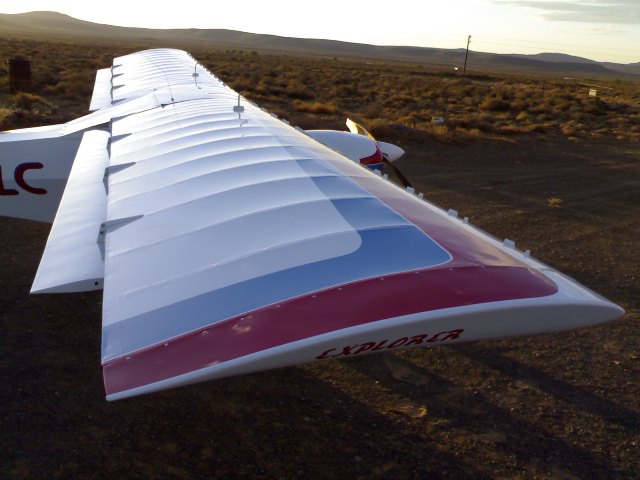

Postby Boet » Tue Dec 26, 2006 7:42 pm
The 2k process that I use is very light. I use ONLY 2 coats of paint on the overall colour. 3 coats where the primary and secondary trim colours goes on. It is true that very litlle of the 2K process consists of solvents. On the other hand, if you go the traditional way and use tinted dope, ready yourself for a LOT of spraying and sanding to obtain even a little bit of gloss..... :D

Fabric covered aeries are not meant to be shiny. And the dope system lasts better - doesn't develop the little "ring" cracking that car paints do. Car paints are made for metal surfaces and not for fabric aeroplanes, even though dope does take more work.

Man that looks nice Boet - Mind if I contact you by phone in the new year for some tips?

Postby Boet » Wed Dec 27, 2006 11:26 pm
Welcome for some tips. We put "plastisizer" in the 2k. It becomes like plastic, and really is very durable. Aeries that I covered and painted 10 years ago, the paint is still flexible. I probably have the formula worked out? :D
The ONLY downside, using poly-u paint is: VERY difficult to patch and repaint. But I have that figured out too....
Added bonus. I did extensive testing on paint and fabric samples. Luck played a big role. NOT any cleverness or smartness from my side. :oops: The fabric does burn. But not explosively so, rather slow / progressively. A good trait.
I once saw a paint sample from an aerie that came short. I measured the thickness = .9mm !!!!!!! Weeeeelll, the aerie was VERY shiny, but it had hopelessly too much paint plastered on. The "painter" probably have never heard about sand paper and/ or the use thereoff....... :roll:
