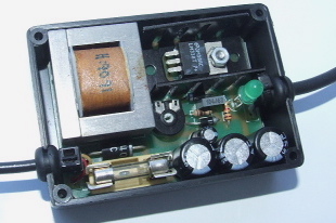

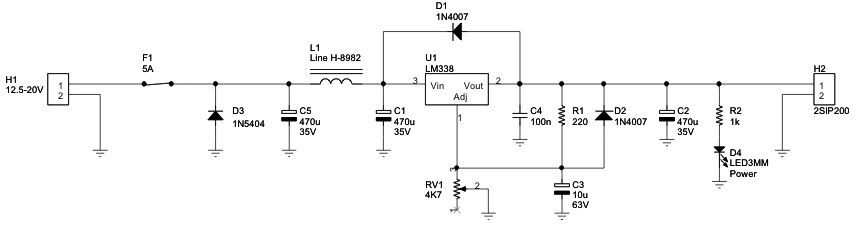

I am happy that Bacchus has won..
For those interested people, i attach a picture of the small power supply that "sorted" Bacchus Buzz problem. I can supply for each individual challenge with a line choke and voltage regulator to suit. LM317 (1,5 amps) LM350 (3,5 amps) and LM338 (5 amps). The line chokes are made in Durban and slightly overkill !!
They work well on all Microlight applications and are strongly advisable for the ICA5/23 series as these units do not like overvoltage. The ICA6/24 really requires it as it takes 11 volts. But highly recommended on all radio feed installations as they remove all line related noise from the planes electrical system. Also desirable to prevent destruction of expensive GPS devices with overvoltage.
I can sell kits for those diy men with interest in doing it themselves and can also help with RF beads to help prevent noise in existing ssytems.
This clearly shows the large line choke
Drawing for interested parties..
