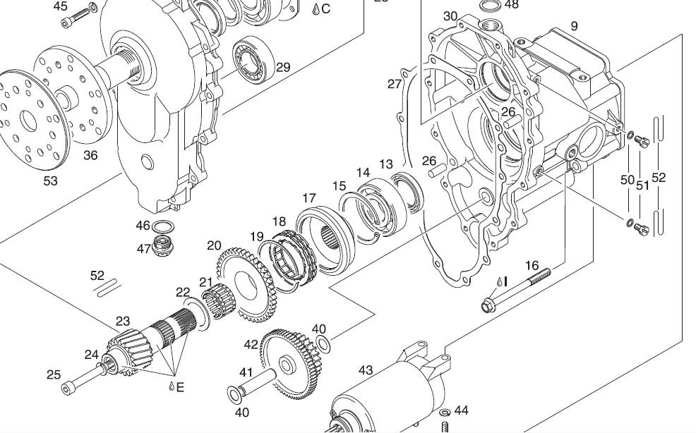

Hi Francois, when the sprag clutch gets older, 400hrs, due to wear of the components, and thicker oil in winter, it does not "grab" the outer race as hard as it should and therefore slips. You can replace the outer race (outer R4000. inner R4000), or just give the prop a manual spin before cranking it with the starter motor. I do that in winter. Also, try to do your gearbox oil change in summer. With new oil and lower temperatures, it tends to happen more often.
Parts 17 & 18.
Parts 17 & 18.
