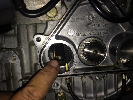

This is the carburettos end of your 582. The black thingy inside that moves when you move the prop, is the one big-end bearing. If you do not treat your aircleanes correctly,

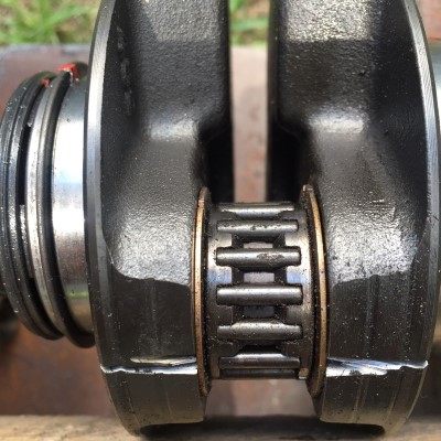

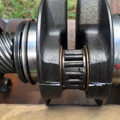

of Rotax clockwork. This is the aftermath of improper air cleaner maintenance. The owner of this aircraft landed himself in hospital for eight months. We had a friendly chat about air cleaners, but at least he was wery glas for the lecture. He honestly did not know, "and poured some two stroke oil over them every now and then".
IMG_4347 (Custom).JPG (60 KiB) Viewed 3516 times

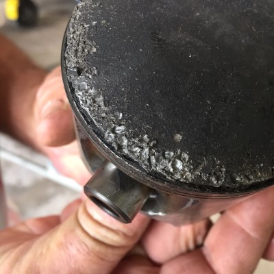

This is the rest of the oil less neclected air cleaner saga......pieces of big end bearing scrapnell dit this to the piston and cyl head.

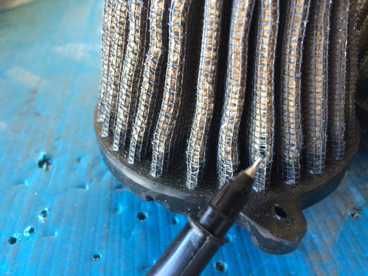

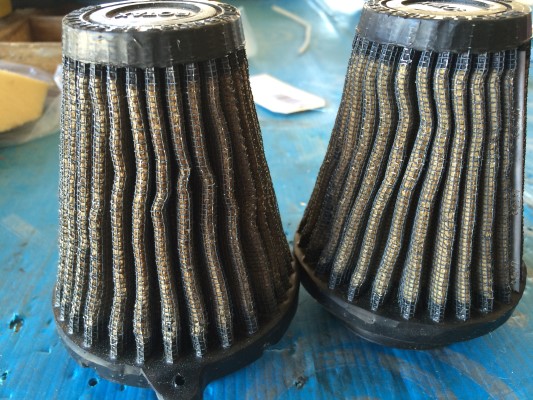

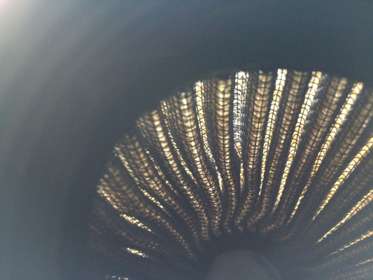

This is what a good set of well knackered air cleaners looks like. It is so full of HOLES,
it will not even stop dust, let alone small stones!!

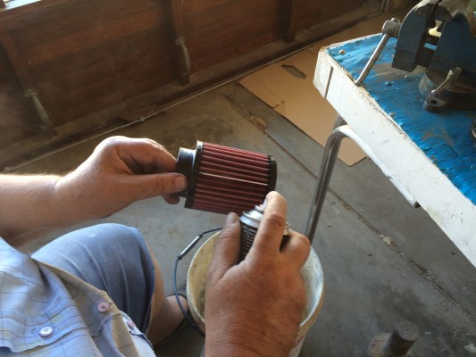

So time to toss them into file no 13, and order new ones. And time to buy a Rotax "Air filter service kit" consisting of two parts, Degraser, and an Aerosol tin of Filter Oil.

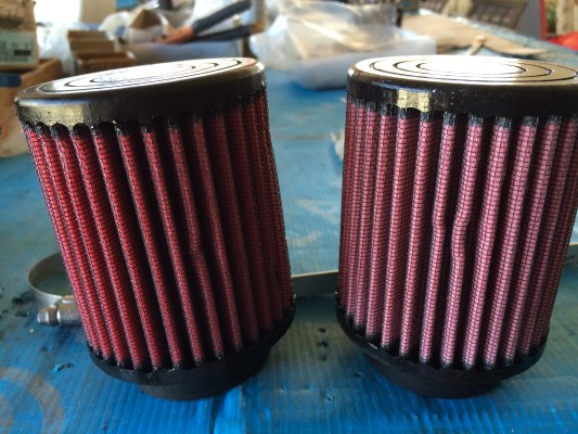

New filters arrived, does not come completely oiled. So you have to oil it properly. The one that is darker red, has been oiled......
And this is how you do it. Begin at the aly "joint", and spray each individual pleat properly, in the troughs too!!

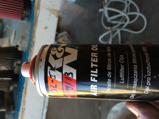

And this is your new best friend, K&N Filter Oil. And no, I do not sell the stuff, I look after aeroplanes! On the long run, a bit of timeous air cleaner oil and maintenance is a LOT cheaper than a new crankshaft. And the same is applicable to Rotax 912 series engines too. Saw a 914 engine with no folter oil on air cleaner.....oooouuuuccch!
