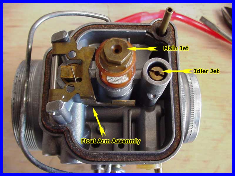

Your main jet/s are gunked up, but the idle jets are still open. Give the carbs a good cleaning.

Remove your main jet and clean them with a thin wire through the holes. Make sure all the holes are nice and clean. You can't always see the dirt purely by doing a visual check.
If I were you I would remove the carbs. Disassemble completely, clean all ports. Inspect all components for wear while you are at it. Adjust the carbs using the standard config. (Clip on no 3 from the top and Air screw fully in and one full turn out)
Do it properly and do it right, get complete peace of mind. This is the part that feeds your engine, you want it to be 100%
See attached doc as well.

Comet Aviation supplies. Do not use a wire to clean the carbs. Go buy a good quality carb cleaner and soak the jets and clean.
- Posts: 1262
Re: Rotax 582 will not pick up revs
Agree, wire can make small gouge marks not visible to the eye, which in turn alters the mixture on that particular carb.KFA wrote:Comet Aviation supplies. Do not use a wire to clean the carbs. Go buy a good quality carb cleaner and soak the jets and clean.
