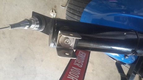

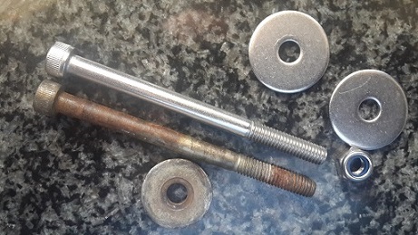

I am busy replacing most nuts and bolts. I removed the profile tube holder bolt yesterday. It is mildsteel from the looks of it and was badly rusted. I replaced it with a stainless steel bolt, ss washer and ss niloc... total cost R9.90. When last did you inspect this bolt? (^^)

Just a question - did you also think of replacing the bolt holding the bracket on :shock:

That is the same bolt. It runs straight through the bracket.

Nacho wrote:I am busy replacing most nuts and bolts. I removed the profile tube holder bolt yesterday. It is mildsteel from the looks of it and was badly rusted. I replaced it with a stainless steel bolt, ss washer and ss niloc... total cost R9.90. When last did you inspect this bolt? (^^)
Beware of stainless steel bolts:
1) they have terrible fatigue characteristics, and should never be used for critical structural parts.
2) stainless steel corrodes aluminium (galvanic corrosion).

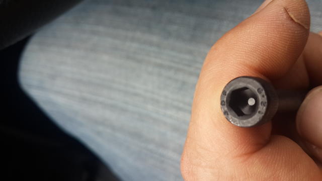

Always be careful substituting components - you do not know what the designer intended when choosing a specific part. I can not see the head of the bolt, but most cap screws are grade 12.9. This has a significantly higher shear strength than the same size AN bolt. So switching to AN could turn out to be a big mistake.
Rather replace with exactly the same spec as the manufacturer used, or confirm with the manufacturer before substituting any part.

Correct Bolt is a HT (High Tensile) with a Hex head.

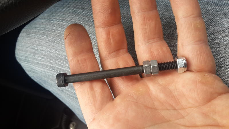

This is the correct cap screw. 12.9 HT
This screw plus Niloc = R3.90

Only use cap screw. 12.9 High tensile
Cadmium plated !
