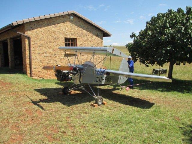

Construction of my Flying Flea is now complete and I ran the engine today for the first time. See photo. The engine is a Rotax 503 UL DCDI fitted with a 3,06 :1 belt drive reduction. Naively I thought I would be able to use a P Prop (70x45) designed for use with a 3.47 :1 reduction drive but the highest RPM I could get was only 4200! I believe that the correct P Prop size for my reduction drive is 70x38.
The belt reduction drive is the same as that used on the older Quicksilver and on the Minimax, I believe. The six prop bolts lie on a circle of 75mm which is smaller than the usual Rotax gearbox drive. Has anybody perhaps got a 70x38 right hand prop that I could borrow for a trial, or buy?
Thanks,
Roy

Wow-that looks very nice!!! (^^)

I saw Pieter de Necker today. He is going to do some surgery on my prop which should solve the problem. We are very very fortunate to have a guru like Pieter in our community. vhpy
