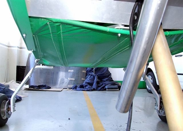

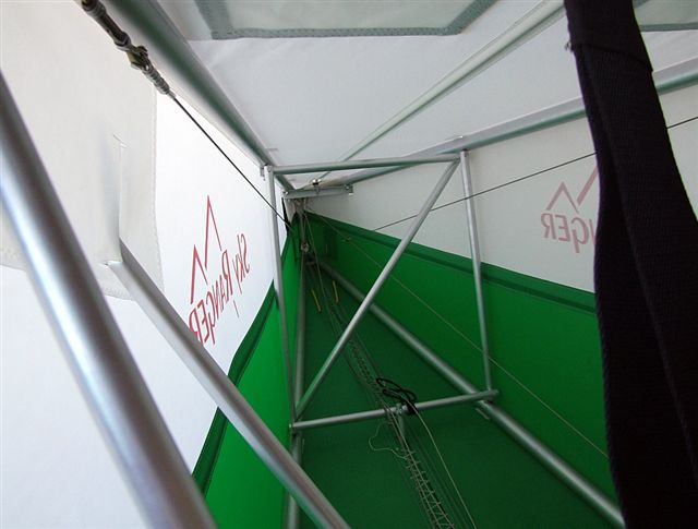

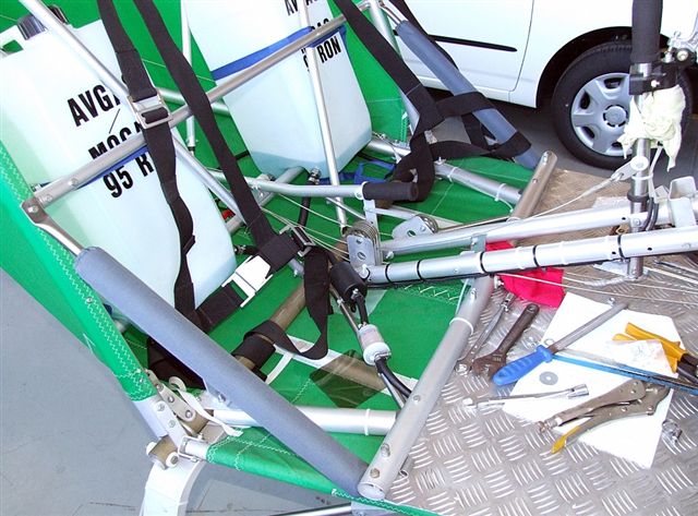

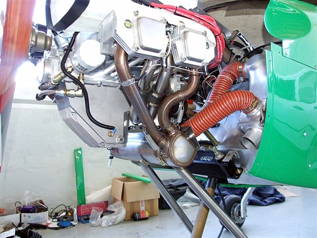

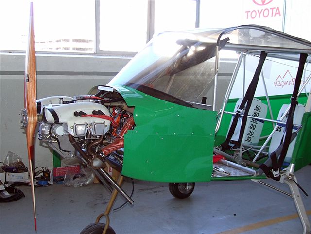

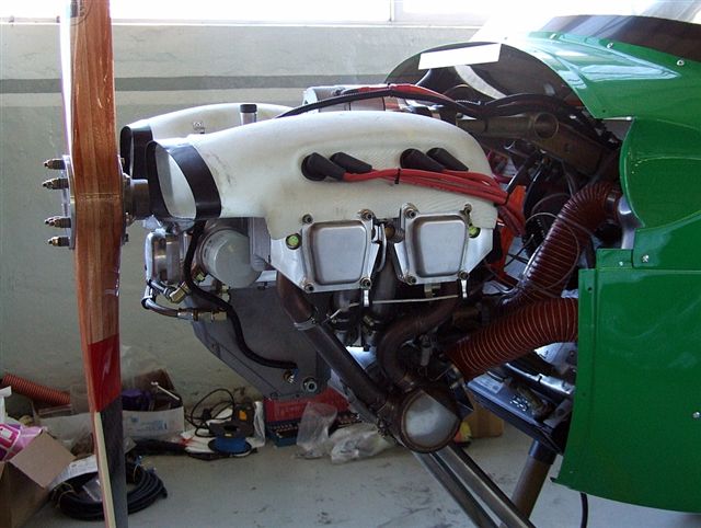

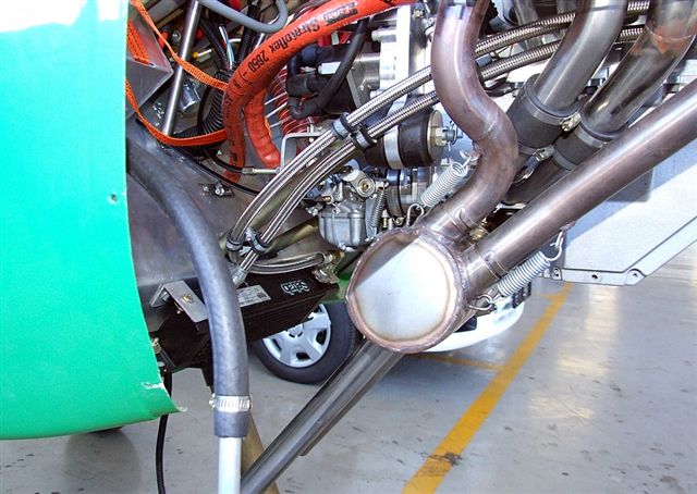

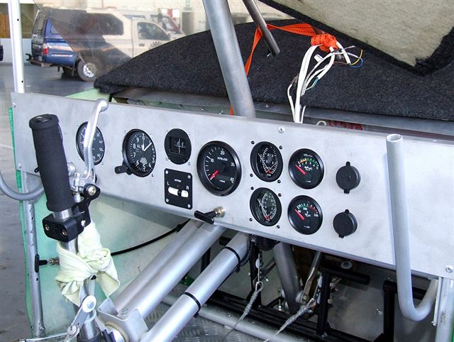

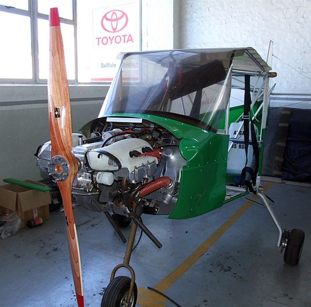

A new skyranger is being assembled by a local businessman in East London....This fine example is sporting the new Jabiru 85HP motor with hydraulic lifters......Here are a couple of pics of the progress....

Postby Morph » Mon Jul 24, 2006 9:00 pm
Nice,
but man that's a gorgeous prop :D
DarkHelmet
Posts: 2046
Postby DarkHelmet » Tue Jul 25, 2006 12:29 am
Beautiful!
On a sidenote... Glorious advertisement for Toyota ;) that is what I saw first... Which dealership? I cannot exactly see - will make a point to look the owner up and demand a flip!

Hello FAWGie
Just one stupid question....! How do you drain any water out of the bottom of the fuel tanks??? :oops: :oops: :oops:

Smiley wrote:Hello FAWGie
No question is stupid....
Both tanks are fed together into a joiner and come into one pipe. There are two valves, one feeding foreard to the firewall and engine and the other with th small tube that allows draining of the tank for water, dirt draining. Usually when wings are fitted with tanks, the probability of water infiltration through the the tank filler cap as well as condensation being so externally exposed is higher than an aircrafts internal tanks with internal filler cap.
Of course there is an online filter to filter dirt, but moisture will still get to the motor...hence the importance to check for water regularly. The hose pick up on each tank is not at total bottom, to allow a water trap there. One could extend the drain tube permanently below the fuselage with a permanent fuel test/drain point.
