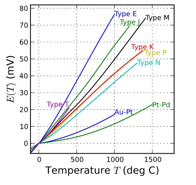

Only a pleasure. Just make sure your gauge is matched to the K-type probes. From the graph you can see the output per degree centigrade is different. K-type = 41µV/˚C and the other popular one, J-type = 50µV/˚C.
