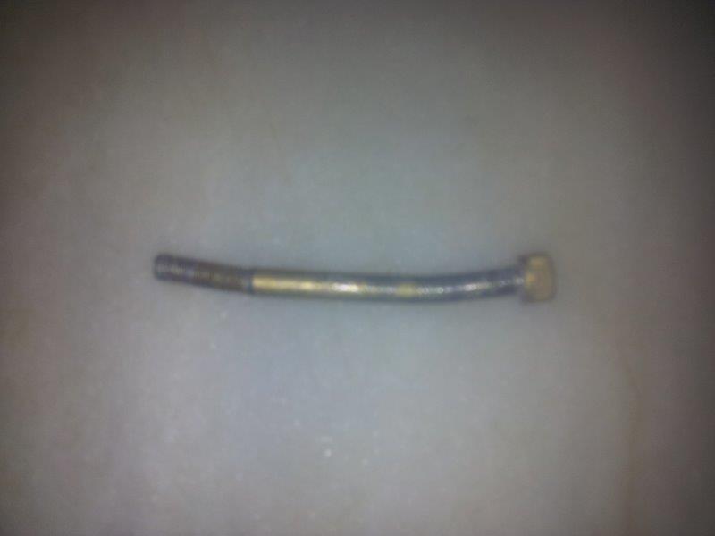

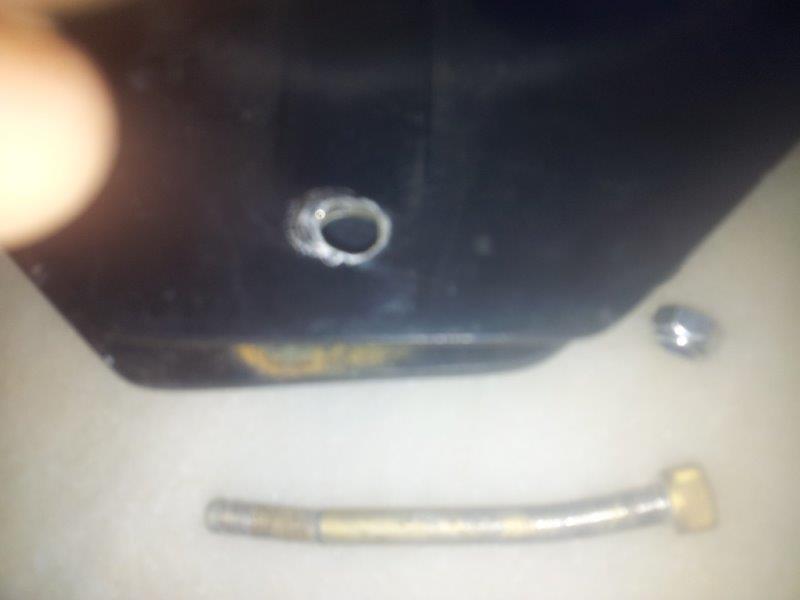

I bought a trike in good condition about two weeks ago. Has 274 hours on wing, engine and trike. Decided to open motor and one ring was partly stuck due to carbon built up. My biggest surprise however was when I decided to replace all the bolts in the wing. (after reading the thread: Can a trike wing fail). The center bolt in front on the nose plate was completely bent and the hole in the plate elongated from the movement. This was completely invisible during an inspection as the bolt is inside the tube and the elongated hole covered by a washer. All you see is the head of the bolt and the nut on the other side.
Bearing in mind that the same bolt holds the fitting on which the flying wires that comes up from the bar to the nose are attached. Scary stuff.
