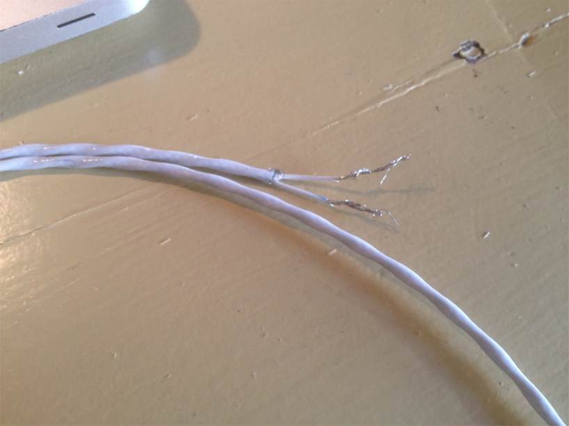

These are they guys for 'specialist cabling'. They supply cable for aircraft, military vehicles, etc.:
Hiconnex (ask for Mark) - in that factory-type area behind the breweries in Centurion
93 Adriana Crescent, Gateway Industrial Park, Centurion, South Africa
Tel: +27 (0) 86 111 1289 or +27 (0) 12 661 6779 Fax: +27 (0) 12 661 6497
Email: sales@hiconnex.co.za
They purpose make the twin core from two single core cables and then coat/heat-shrink the covering on.
These guys were recommended to me by CN Lighting (http://www.cnlighting.co.za), who make strobes and who get their supplies from them.
If you would like I will bring a sample through for you on Saturday.

Re: Rewiring of Strobe/L Light- Need Cable.
Hi Bundy
You can get shielded Tefzel wire from Jaycor http://www.jaycor.co.za. They are in Eastgate in Sandton. Tefzel is what most certified aircraft are wired with. For a strobe light, you should use shielded wire and earth the shield at the power supply end only to prevent radio interference.
Don’t know what current you are drawing, but 16AWG should be ok for about 3amps in longish cables. The wire can take much more than that, but you get a higher voltage drop.
You can get single core silicone wire from most cable suppliers – it is used to wire stoves in houses but it has thick insulation and it’s heavy. I think you can get shielded silicone twin core from Jaycor as well.
