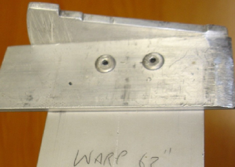

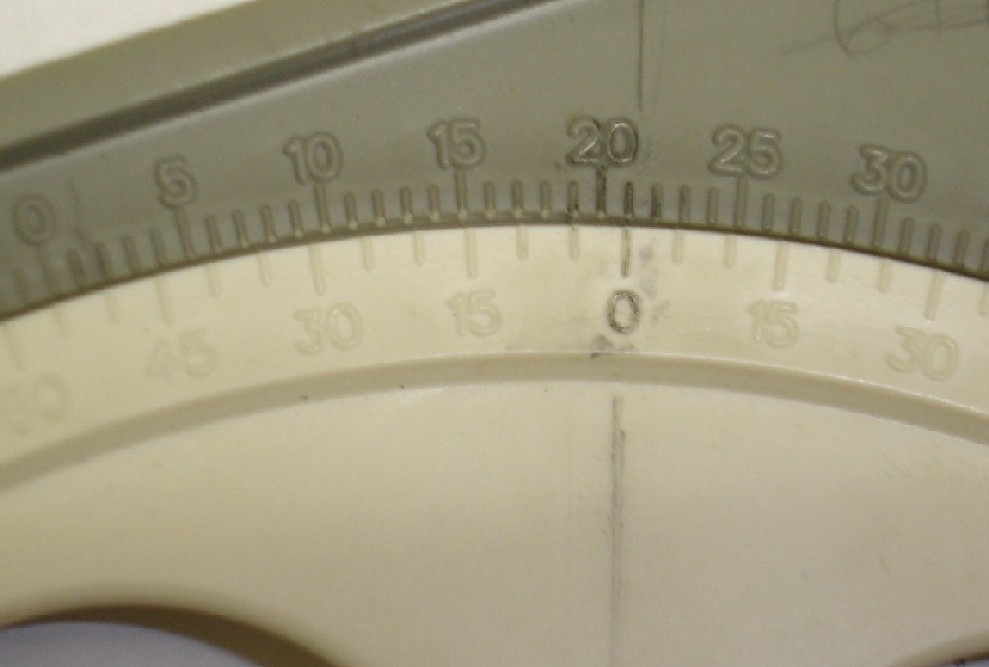

Postby Junkie » Tue Jun 06, 2006 8:35 pm
Pitch settings measured tonite - hope it makes sense
21deg from vertical measured on the upgoing blade (left blade looking at trike from rear) 50cm (19") from prop flange bolts
Homemade Pitch tool
Pitch 3.jpg (86.2 KiB) Viewed 1811 times
21deg pitch
Pitch measured from Vertical
Pitch 4.jpg (87.67 KiB) Viewed 1811 times

Postby Duck Rogers » Tue Jun 06, 2006 10:38 pm
Yep, good enough for me.......thanks for the effort Junkie :D
