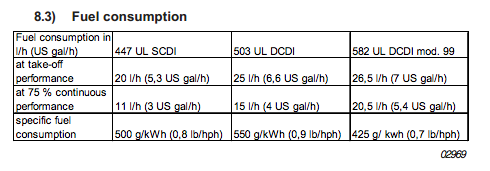

I have tuned my carbs in accordance with Paul Mulders' notes (thanks Paul!) but am still at 24l/hr in the climb and 14l/hr in the cruise! EISH! Fuel prices are killing me! :shock:
This is what the Rotax 582 manual shows:
Rotax 582 Fuel Consumption.png (34.25 KiB) Viewed 10021 times
So according to this my fuel consumption does NOT appear high, but I am convinced it is and that I was flying a lot more economically six months ago!
I would greatly appreciate any advice.

What you are burning sounds about right. 2 stroke rotax are fuel guslers. Might get better fuel burn if its not a trike, but not much better.

Your consumption sounds about right. I have a fuel flow meter on my 582 which gives me real time consumption. It is not 100% accurate but close enough. Taking a pax adds about 3-4 l/h. What I did notice is that the higher consumption is not really an engine rpm issue but just that the engine has to work harder to achieve the rpm. I cruise at about 5000 rpm dual or solo but the fuel burn is lower solo. ($$) ($$) Case in point, if I dive and keep the rpm at 4500 she burns 4 l/h. Idling stationary on the ground burns 7-8 l/h, horrific aint it. When taxiing it drops to 4 l/h.
Solo cruise - 5000 rpm @ 10 l/h
Dual cruise - 5000 rpm @ 14 l/h
Solo Max climb- 6450 rpm @ 25 l/h
Dual Max climb - 6450 rpm @ 28 l/h
It is true that the carb jets become worn bigger over time and this will increase fuel consumption. I replaced my main jets, needles and needle jets at 150 hrs and will do this again at 300 hrs. Costs about R700. I can not say that I noticed any change after replacing them but, for safety sake, I do what the manufacturer recommends. puff

Thanks a lot Paul (and others!).
This makes sense and is in line with my current fuel consumption rates.
You've just saved me R3,500!! (^^)
