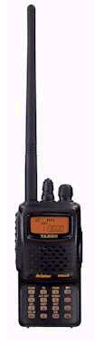

Hi guys
I'm really g@tvol of having radio issues and at the point of throwing my radio in the trash :(
Sometimes people can hear me 5/5 and at times (fairly regularly) for no apparent reason 1/5
I have a brand new Airmagic chatterbox, new Airmagic headsets, Airmagic V-rabbit antennae and ...
Vertex Pilot 3 (VXA-300) radio:
Anybody have this combo without issues?
Paul reckons I should have rather gotten the VXA-200 as it works better with he's chatterbox system!?!?:
Can someone tell me technically why the VXA-200 would be better than the VXA-300?
And anybody wanna swap me a 200 for my 300!? :lol: :lol: :lol:

Air Hog wrote:Hi Ant
I have an almost new VXA-220 which I only use as a hand radio and I know it work 100% with Chatterbox, I will swap
Thanks Johan, I'm going to try another antennae tomorrow to see if it makes any difference, will let you know if you still want to swap
Still wondering technically why the 220 works better than the 300, always thought the 300 is better since it costs way more...???
http://www.yaesu.com/indexVS.cfm?cmd=Di ... Archived=1
The Vertex Standard VXA-220 Pro VI is a compact, stylish, solid and submersible hand-held transceiver providing communication on the International Aircraft Communication Band. Additionally, it provides receive on the Navigation Band.
The VXA-220 boasts 700 mW of clean audio output and it also provides 8.33 kHz synthesizer steps for the new narrow-band channel plan.
The VXA-220 displays information with our exclusive Omni-GlowTM display back-lighting for minimal degradation of your night vision. NOAA weather band monitoring, 8-character Alpha/Numeric Display, 150 Memory Channels, 100 “Book Memory” Channels, VOX, and Side Tone are just some of the many features provided. The channel configurations can be easily reprogrammed in minutes using the optional PC Programming Kit and your PC.
The Vertex Standard VXA-300 is a compact, stylish, solid hand-held transceiver providing communication (transmit and receive) capability on the International Aircraft Communication Band ("COM" band: 118 ~ 136.975 MHz), and it additionally provides VOR and CDI navigation features on the "NAV" band (108 ~ 117.975 MHz).
The VXA-300 boasts 0.8 Watt of clean audio output from its 1.4" (36-mm) diameter loudspeaker, and it also provides 8.33 kHz synthesizer steps for the receiving of the new narrow-band channel plan. The VXA-300 includes both Temperature and Supply Voltage displays with our exclusive Omni-GlowTM display back-lighting for minimal degradation of your night vision, NOAA weather band monitoring, 8-character Alpha/Numeric Display, 150 Memory Channels, and up to 100 "Book Memory" Channels. The channel configurations can be easily reprogrammed in minutes using the optional PC Programming Kit and your PC.

Hello Ant and others, I do advise this in our instruction manual, also the Vee rabbit if too close to other stations will cause distortion. Main reason we dont advise the VXA300 is the fact that they pick up external radios stations from FM towers, I do know that Kroon has a FM mast nearby. This probably is why they have a transmit problem as well. The VXA220 and FTA230 have zero problems as many will report. Same reason as we no longer support the ICA6/24 series. Its not a Air MAgic product problem as we have clearly identified this with hundreds of hours of test flying. I have never had acceptable performance from a VXA150, 300 or 710 series. The older Icom ICA4 performs better. I advise owners and always get the same reply, I will try it and see. We have tried them and have seen !
For info..cut from instruction book for chatterbox series.
"Radio compatibility
The chatterbox has been upgraded over the past few years and supports many radio types. Air Magic advises the very popular Vertex Standard VXA220, this gives the ultimate performance possible with this system when coupled to the Vee rabbit trike antenna.
Other aviation radios that perform well with the system are the following: Icom ICA3/22, 4, 5/23,14, 200 and 210 series Microair 760
Radios we do not advise are the following but may be interfaced as a factory request:
Vertex standard VXA150,300 and 710 Icom ICA6/24 series which we advise to not use as this has a specially designed interface.
The standard chatterbox comes with a interconnect plug that allows a radio change without sending the unit back to the factory."
As always we are on stand by for technical help where needed and do try our best to sort out problems where possible...
Incidentally the VXA300 is more expensive as it has a VOR function, it was also designed years ago. When the VXA 220 came out, i did contact Yaesu way back and advised the faults with it, namely the SMA connector, i had one come out in flight, the non standard power connector and I moaned about the CT96 connector. With the FTA230, they fixed the SMA replacing with a BNC, they make a panel mount power cradle. We fixed the CT96 issue with a quick coupler. Now a perfect trike radio..probably didnt take my mail into consideration but its sorted now.
Just wish we could get spares for some of the older Icoms..we will no longer support the aged Icom ICA2/20 series and have stopped moulding the Icom twin plugs now.
Thanks Paul
