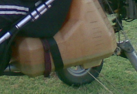

Re: uesful fuel Cobra trike
A way to also determine what is usable.
When i setup the fuel gauge on my Sunbird i was told that the gauge should show empty when there is about 10% fuel left in the tank so on a 50L tank there should be about 5L still left in the tank - I still have a 10L headder tank so when my fuel gauge hits empty i know i have about 40min before i get into Big dwang and the motor will go quiet.
When i am flying the Trike i have a line that when the fuel gets there then i know it is time to land - there is enough fuel to get me at least another 15min before i seriously start to get that Pucker effect.
I have attatched a pic of the last flight i took - the fuel was on the Bingo Line and that means it is time to Land - anything after this is playing with a live handgranade It will bite you in the ASS.
- fuel in tank.jpg (44.67 KiB) Viewed 1998 times

Hi Tailspin
Problem with the Cobra trike is that you can't see your tank from the outside,not even on the ground. Behind the side covers. Only way is with a reliable fuel gauge and to use the time you fly. Have a dip stick that I have calibrated myself that I use before a flight, and a fuel-flow meter while in flight.Is a bit of a hassle not to visibly see the level. Got a Flight 2 instrument panel and the fuel gauge is quit accurate after calibration. Will pump out all the fuel myself to detect what is useful and what not.At this stage it does not look if any Cobra pilot can give me a answer. That by itself is quit alarming, or perhaps thy are not on the site.
Fly safe
Gompou
Fly safe
