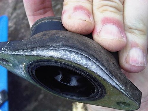

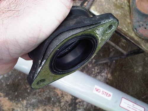

I have problem with the Rotax 912 carburator sockets were the rubber get separated from the steel insert part.
In my club, almost everybody with 912 engines, has exactly the same problem with these carburator sockets showing the same type problem.
Please look at the pics. My 912 is like 18 months old and it only have 52 hours of use and this part have fail. Also, you will see a white powder. I dont know what is that.

That white deposit looks like "white rust ", a type of rust that you find on aluminium and similar type materials. ( mostly seen along the coast .... we dont see it up here on the highveld much. )
