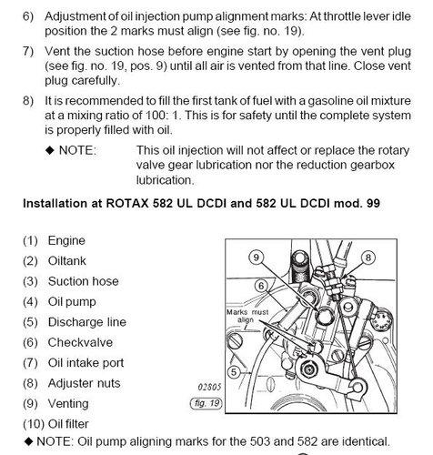

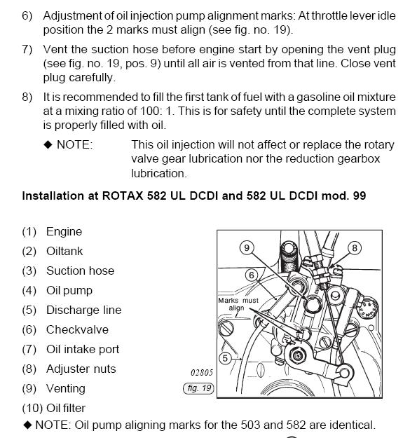

Is your engine tilted downward at the front when standing in the hangar? Oil is running into the rotary gear housing and draining into the lower carb, (front one)
Sounds like your autolube is staying open even at idle. Check the set up. At idle the marks must align

Ok not much support for autolube . But it works (for now)! Inspecting cables confirmed metering lever is closed at idle(ie marks align). Looking down the throat of forward carby a pool of oil is gathered around the small nozzle and is pooling toward the aircleaner. Yes the motor does cant forward (prop highest point). I wonder if there is a lazy check valve in the system. ?

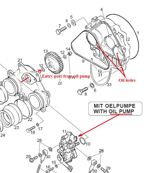

see Pic,
You can see the holes that feed the oil into the two carb intakes. There don't appear to be valves here. The oil is injected via the oil pump into the rotary valve casing via the port. The only way oil can be leaking through to the carbs is due to the oil pump not sealing off when closed. I don't have a schematic breakdown of the pump itself, sorry.

I was under the impression that oil was injected via these two lines from the oil pump . These lines run along engine behind carbs .
OK- so it sounds like good design to pump oil to the rotary valve face. So what do these two tiny lines do.?
