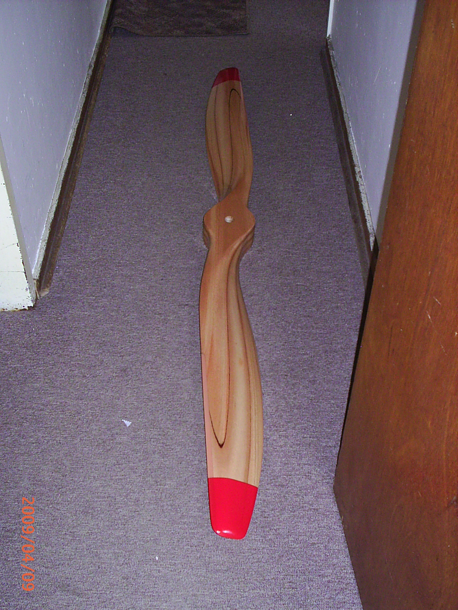

Re: Which Prop?
I'm sure that someone will offer me a home for my P-Prop but I now am the owner of an Aero prop and the P-Prop is in its cover waiting for someone to make me an offer I cannot refuse! I already have a wooden prop with a clock in it.
I certainly enjoyed the lively debate of the "wizards" about the pro's and the con's of the P-Prop vs the rest. There were two schools of thought including a debate on the validity of the static test.
What sold me was the sheer inflight difference - greater climb rate on take off and greater airspeed ( which I only experienced after buying the Aero Prop on the strength of the static test results). Anyone with a serious interest in this matter is invited ( by arrangement) to fly the trike with both props at Petit.
PS If you want to see the P Prop it is proudly featured on the cover of the Xmas edition of Microflight Africa. It was in fact this photo shoot that got the ball rolling on the debate about the thrust that a P Prop generates. Actually I cropped the picture to focus on the Xmas theme so you do not actually see the prop. After the photo shoot a "wizard" took my trike for a "flip" and suggested that it would perform better with an Aero Prop. The rest is now history!

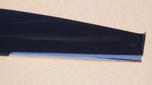

Very interesting post .Who are the agents for the Aero prop? Anybody got any photos of this prop?

Re: Which Prop?
I'm not sure who supplies them - I bought mine through Hans Schouten / Mervyn Reynolds ( Sky Riders) - it is a hollow carbon fibre prop that has the turned over tips.
I did an internet search:
This propeller is offered on Apollo trikes. After extensive testing Apollo North America, Inc. has found the Aero prop to be better than all other props Apollo tested on 912, Suzuki 4-cylinder conversion, Suzuki 3-cylinder conversion, Rotax 582 and Rotax 503 engines. Apollo welcomes you to prove them wrong. The anti-vortex tips help reduce noise and give it its cool look. Black or black with white tips (on some models) and riveted solid stainless steel leading edge protection (not tape).
see: http://skyboundlsa.com/aero_prop.htm
