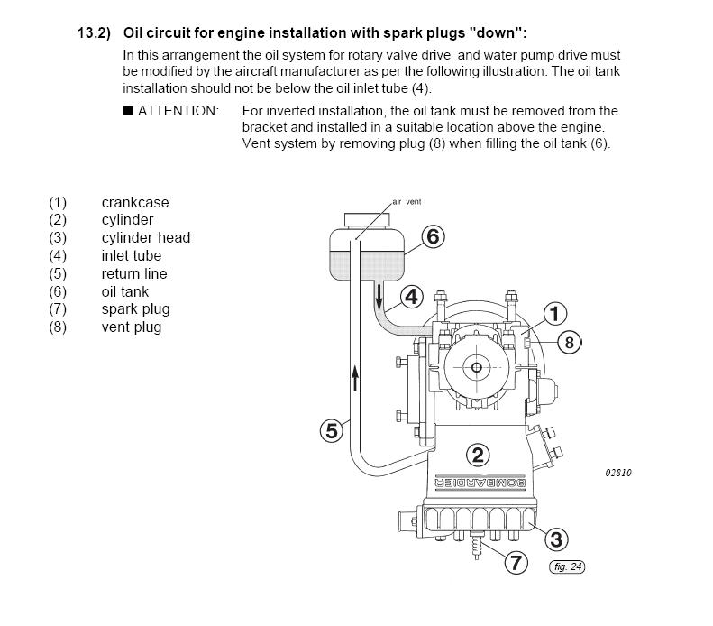

I Fly a 503 windlass and the motor is inverted.
Would it be possible to mount the 582 on the current mountings and still keep the motor inverted?

Yes... vhpy

I did my training on a Windlass with upside down 582.... (^^)

I will post pics of my up-side down 582 on the Windlass done by Alex Rudd.
Works very well.

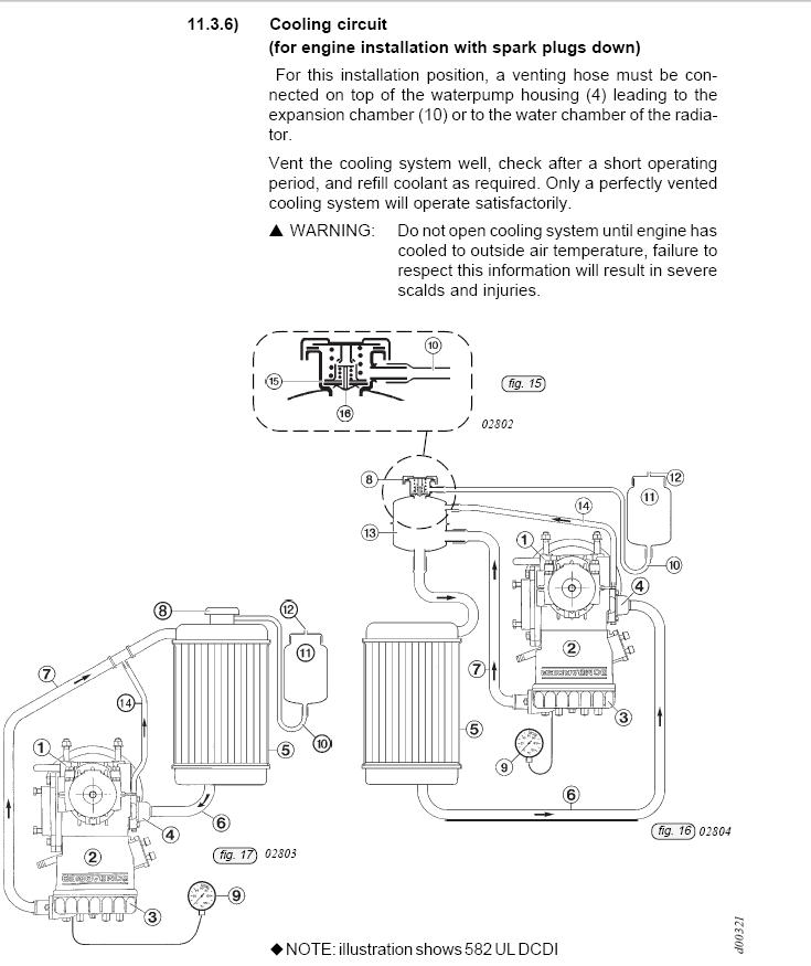

Postby Morph » Tue Aug 18, 2009 9:35 am
Here is some information
