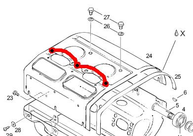

Postby Morph » Mon Jul 20, 2009 9:36 am
Then next, install a set of bungies to hold them in place
503 Bungy.JPG (23.27 KiB) Viewed 1611 times

Hi Morph. Might just consider it now. Just the few trikes I have seen with them on looks really crap. Very untidy. Will see what I can do. Thanks

Better to look crap than crap yourself with a spluttering engine Karl :lol: (^^)
