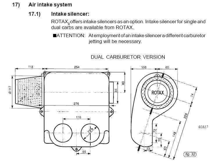

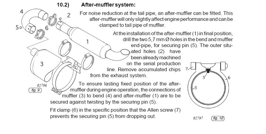

Postby Morph » Tue Jun 30, 2009 3:21 pm
You get an Intake silencer and an after muffler from Comet Aviation (ex Aviation Engines) that are used to quieten the engine down. Quite a lot of local noise is generated by the air intakes

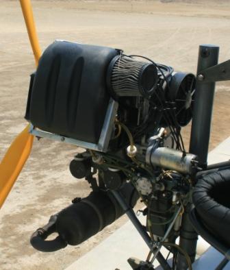

This is the set up one of the trikes in Peru had. It has the intake muffler Morph described and an after muffler. It was noticibly quieter. personally i don't find the 503 too niosy.
perumicrolight 003crop.JPG (28.58 KiB) Viewed 3455 times
