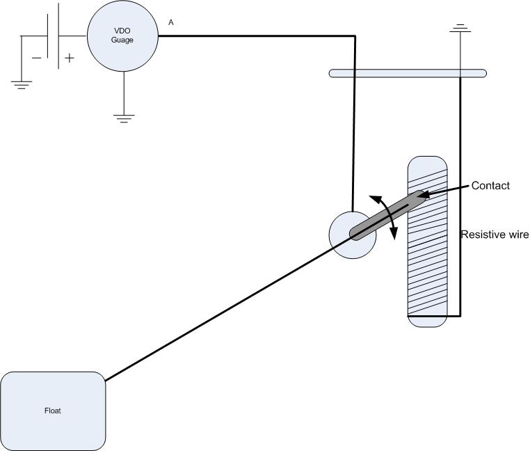

Fuel level sensors are usually resistive, i.e. they have a float that moves up and down and this then moves a contact along a winding of resistive wire. The one side of the wire is connected to earth. The concept is the float moves the contact up and down along the wire windings, adding more or less windings and as a result increasing or decreasing the resistance.
This mechanism requires minute amounts of current and voltage and as such will not ignite the fuel.
Now the first test is to see if you are getting varying resistances. Get a Fluke multimeter, and connect it between point A and earth. (disconnect the VDO unit at this time)
Start with an empty tank. add fuel to the tank and measure the resistance. Try and get the minimum and maximum readings in ohms.
If you get no readings, then the earth wire is missing from the flange of the tank to the earth or the wire from the center point to point A is not connected.
If you get a fixed reading then the float is stuck and not moving
if you get variations of ohms, check your gauge to see what it is expecting. You might have a high resistance sender with a low resistance gauge or if the tank is not a standard shape the variation in resistance from full to empty is too small.
The MGL gauges allow you to calibrate your sender and gauge to handle any shape of tank. There is an empty, full and 4 or 5 other points. You add say 20 liters of fuel, get the reading off the sender, then tell the gauge that this is 20 liters as an example. The electrical gauges don't give you the option to calibrate

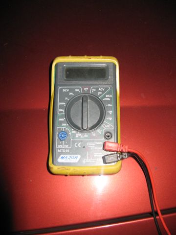

Seeing as we are being overly pedantic
here is the "Fluke" that will do everything for you at about R180
Apologies to the experts
Major Tech, as good cheaper version of the fluke
