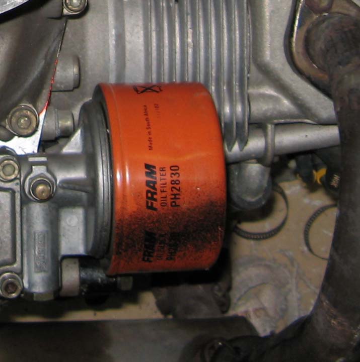

ANY NON AE OIL FILTERS FOR 912?

yes,
Fram PH 2830

Morph wrote:yes,
Fram PH 2830
Can we use it on the 914 as well ?

Postby Morph » Wed May 20, 2009 9:55 am
If it is the same filter as the 912UL and ULS then I don't see why not. I personally am using the Rotax filter from AE which the last time I bought was about R80, which isn't a major issue.
Remember Rotax will not warranty a motor that is not using their components.

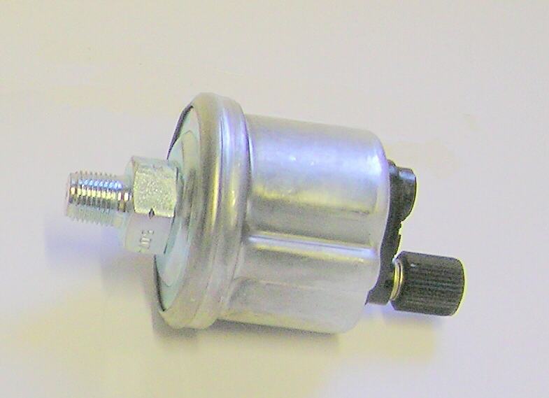

Oil Temp and Pressure senders - Standard VDO, available from any good spares shop, just match up the correct pressure or temp range

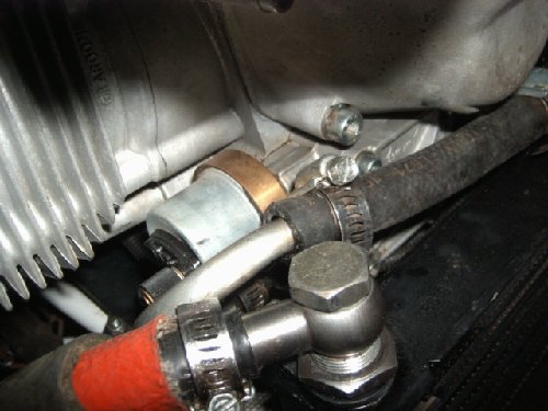

Morph.Why dont they use the double oil sender unit which also triggers the oil warning light,and what "rubber ring" have they got around the vdo oil sender" Vibration?

Good question. There is no reason that unit would not work if it uses the same fitting
Here is a pic of the unit.
What "rubber" are you talking about. Mine doesn't have a rubber
Remember to get the low pressure unit, 0-10bar

Brass ring on rubber like a damper.
Re: 912 OIL FILTER
Postby Morph » Mon May 25, 2009 11:44 am
Nope got nothing, but then again I have 150hours on the motor and already replaced one unit, so perhaps I should have
