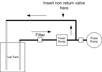

After installing my new Facet pump yesterday Facet 40105 3 - 4.5 PSI, I have a small problem.
I have a Cobra with 2 x Pickups on the top of the tank. I installed a filter after the one pickup and the Facet just after that going to a T piece.
On the T Piece I have the second pickup connected and the 3rd part going to the main fuel filter, then to the mechanical pump supplying the two carbs.
I rebuilt my carbs, from scratch. So when I installed everything yesterday, and after running the Facet for about a minute. Pls Note: completely empty carbs. I could not get the 582 machine to start. The carbs stayed empty. Eventually I manually filled the bowls and tried again. I started in no time, and it ran perfectly.
2 Q's
- Wasn’t the Facet pump suppose to fill the carbs bowls?
- Did this happen due to air in the fuel system?
- Will this pump be sufficient, to supply the carbs when the mechanical pump fails? Seeing that it didn’t fill the bowls.
Please note. The Facet is installed at a higher level that the fuel level, due to the pickups, coming out on top of the tank. I will say about 10cm higher than the tank.
2 Q's
Re: Facet Q
the facet is a one way pump. Fuel picked up by the facet is returning to the tank via the other pickup
either put in a one way valve on the other pickup, or preferably put the facet in series

Re: Facet Q
Yes it will, you will hear the pump with a sharp sound and later as the pressure builds the sound will become dull)Nacho wrote:
2 Q's
the pump will work fine, it can suck fuel up to a meter higher than the tank and it is self priming, i.e. will suckout theair first.The Facet is installed at a higher level that the fuel level, due to the pickups, coming out on top of the tank. I will say about 10cm higher than the tank.

Thanks Morph. Will go the non return valve route. Was mission to mount the Facet, so I dont really want to move it now.
Your help is much appreciated. It actually makes a lot of sense, doing it like that.

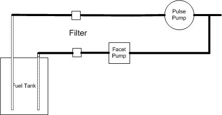

Re: Facet Q
very good question, there is usually only 1 pickup and the series setup works perfectly. The facet will allow the fuel through without obstruction
another way of doing it is a competely parallel system,
- Facet pump installation true parallel.jpg (9.78 KiB) Viewed 3233 times

Re: Facet Q
Thanks Morph. Will go the series route and disconnect one fuel supply out of the fuel tank completely.
Tried getting non return valves. Not easy to find. Would also like to keep it as simple as possible.
