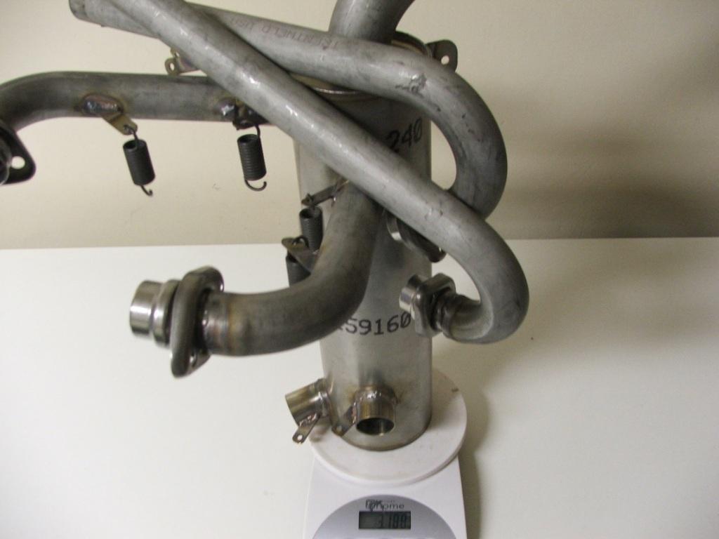

My kitfox exhaust weigh in at 3.2kg

Goose wrote:My kitfox exhaust weigh in at 3.2kg
It is not the Rotax exhaust ?

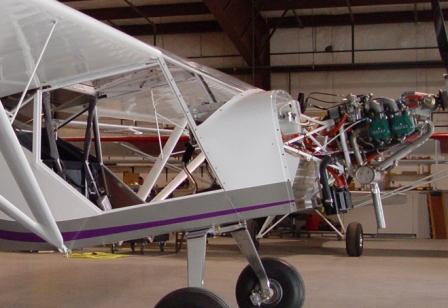

Re: Weight of a 100 hp Rotax ???
Postby Goose » Mon Apr 13, 2009 9:24 am
exhaust installed
