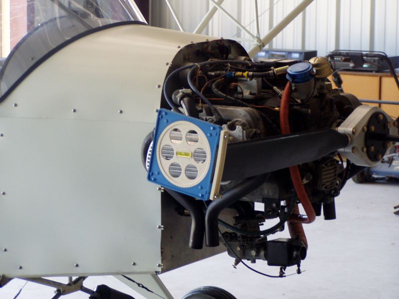

If you don't find one of those get one of these. there is a spirit level on the other side. The inner part rotates. Place the flat section against the flat part of the blade, rotate the inner part until the bubble is in the middle. Note this down. Then add or subtract the degrees you want to increase or decrease your pitch
- protractor3.JPG (17.43 KiB) Viewed 3255 times

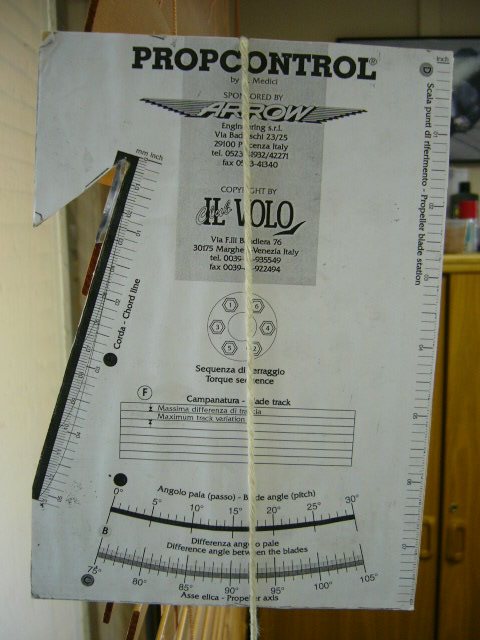

I have a very simple, yet effective way. Unfortunately doesn't like wind, but inside the hangar it works brilliantly. I have pitched three gyro's blades with this without any vibration.
Only downside is you have to have a start, cause it is tricky to set the blades to a specific degree at first, but if you just want to go finer, or coarser that litle bit, it is perfect.
I borrowed this from a friend, then made copies, pasted it on cardboard, cut it out, and voila. If interested, I can scan and e-mail it to you.
O yes, there is a little weight on the string to let it work like a plumb-line.
