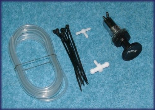

Fitting a hand pump also works but it has its drawbacks. The rubber goes hard after a while. The best way is to fit a syringe type primer....it primes the carbs with fuel directly into the intakes or you can fit a Facet electrical pump.

I had a very hard to start 582, and the little syringe primer pump (available from the Rotax agents) solved this problem for good. A Facet electric pump would also be a good choice.

Get a primer Nick. Looks like a syringe. Couple of squirts and she starts right up.
These things squirt fuel straight into the inlet throats of the carbs AFTER the carb body, akin to pouring a capful of fuel straight down your car's carb throat.
