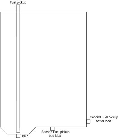

I am going to fit a second fuel supply line, to the bottom of my tank, hook the Facet and a filter up on this line and add a Y-fitting, just before the maechanical pump. That way I am sure that should I have a failure, due to the outlet from the top of the tank being blocked or the primary filter being blocked, fuel will get to the carbs.

The fuel pickup taken from the top has a tube extending down into the tank into a well at the bottom. The idea is the well acts as a water and dirt trap. The tube does not touch the bottom of the tank thus preventing water and dirt from being sucked up. Having a pickup on the bottom surface of the tank is risky wrt picking up water and dirt.
Either have the pickup off the side or better still t-piece off the top of the first one. The less holes you put in your tank the less chance of leaks.
Speak to Hyflo for valves and pickups and taps etc.
- fuel tank pickups.jpg (11.09 KiB) Viewed 3944 times

Excellent, thanks for the advise. I was planning on adding the additional pick-up on the side.

Ask me, I knowMorph wrote:Having a pickup on the bottom surface of the tank is risky wrt picking up water and dirt.
I've just installed a complete, seperate line with an electric pump and I took the second outlet out the side, slightly higher than the original bottom outlet.
