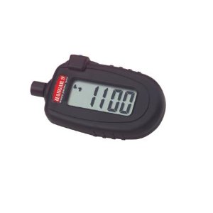

This is the tachometer.

Thanks. Hope the rain does not affect the reading :lol: I assume it is usable on a Trike prop. RC props are a lot smaller? :?:

Btw Faizel I have the same tach as you and I dont think it will work for 3 blade props, luckily Ian had one which you can set for 2 or 3 blade

anthonyhugo wrote:Ian found the problem! The timing was out and the rpm guage is faulty
So now to buy a new rpm guage... Wonder if the Midas VDO brand will work?
Go digital Ant. My tacho can do 2/3/4 blades.

Thanks Faiz how do you set it to 3 blade? It only has on/off button (Hangar 9)? And any suggestions on digital rpm guages besides going the full DX2 route?

anthonyhugo wrote:Thanks Faiz how do you set it to 3 blade?
Press the button quickly and it will change from 2 to 3 to 4 to 2. It does display the prop on the UPPER LHS which blade mode you are in.
Got it thanks a mil! :)

Thanks Faiz for the test on Saturday. So my tachometer is good.
