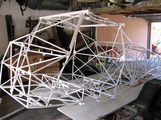

The BB airframe is mig welded in a jig (no "hoenderkak" welding here). The company is certified on airframe welding and repair so they know what they are doing. The chances of the airframe cracking is quite remote. Nuts and bolts have the tendency to come loose or to wear the holes oval. The BB frame can easily be repaired using a simple welding plant, some mild steel tubes and the obvious know how. I saw BIF after it fell off a trailer while being towed and Boet simply cut out and replaced pipes. She is perfect again.
I would say IMHO the BB frame is significantly stronger than the Cheetah but due to the fact it is mild steel has to be powder coated to prevent rust. I have attached a pic of the powder coated airframe. You can see how perfectly welded it is and how lattice and triangulation is used to add strength. A Cheetah airframe is far simpler and much fewer tubes and angles. You can actually see the fuse moveing in the air if you look back.
