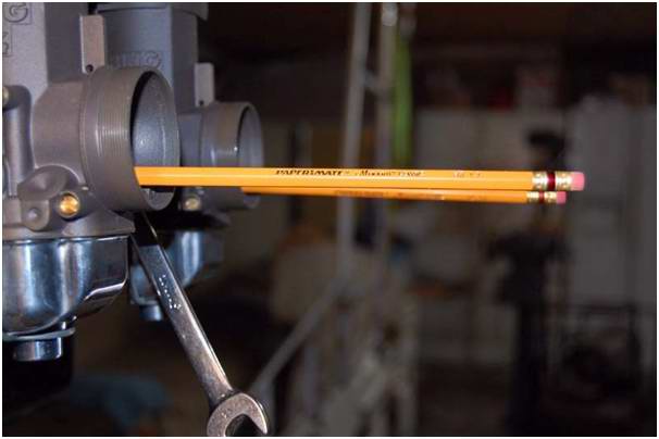

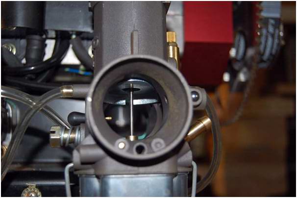

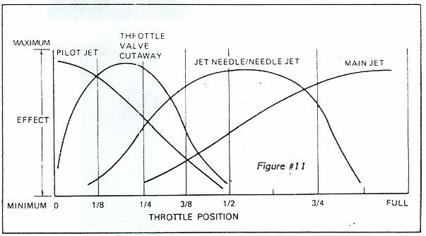

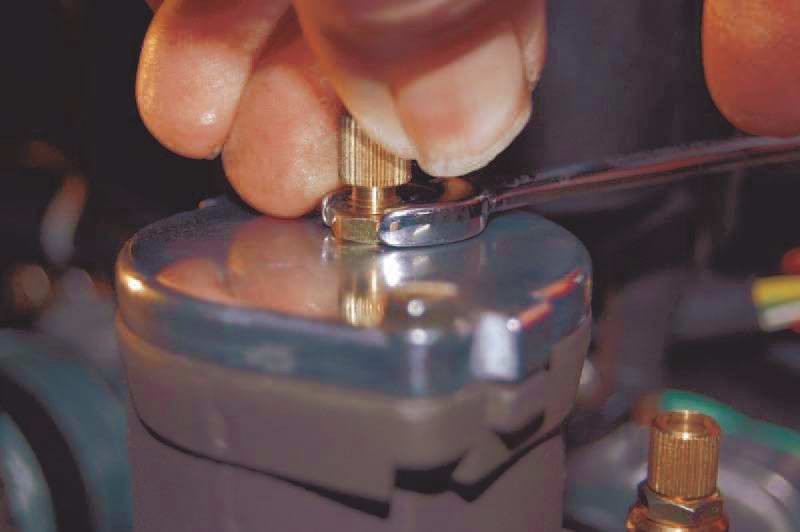

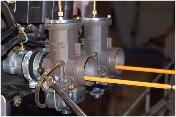

Ok. The carbs one. I have separated the figures so that each file is less than 100kb. This is pretty much what Mike showed us last Saturday at Microland.
Callibrating the Bing Carbs on 582 no pictures.doc
(44.5 KiB) Downloaded 1192 times

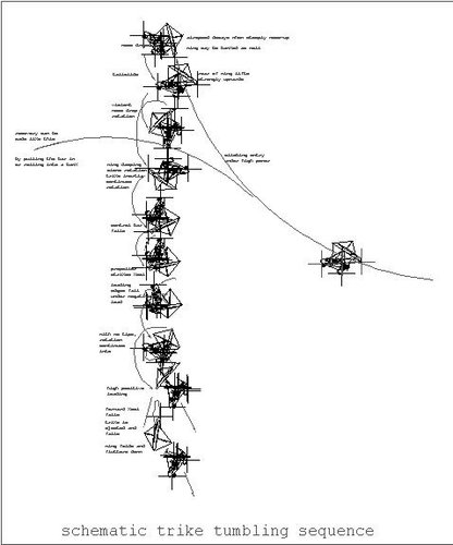

I found this interesting article. Some of it may be old hat and some you may have forgotten already. Again, the figures make the file to big, so I have separated them. Hope it is as intersting for you.
How to fly a flexwing microlight.doc
(45 KiB) Downloaded 439 times
Fig 11
Fig 12
