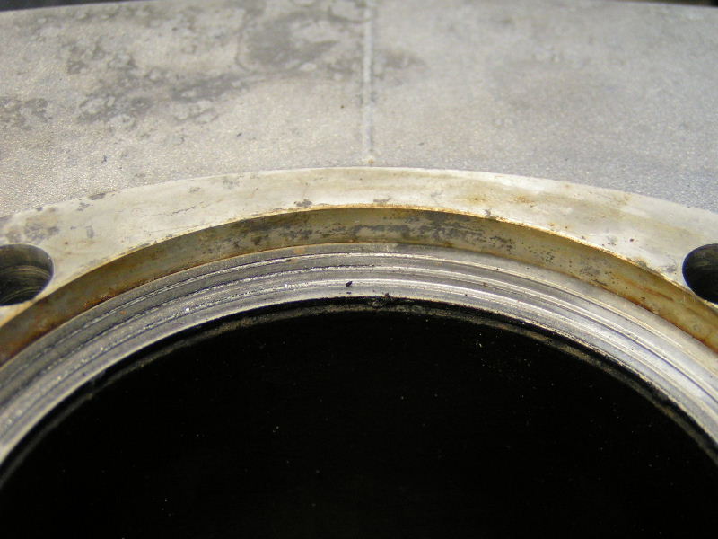

nickjaxe wrote:<SNIP>...if you could take a picture of the head for me, <SNIP> I need to be able to see is the depth and shape of the groves on the sealing surface on the head cannot quite see it in your pics, so a good close up would be fantastic <SNIP>.
Nick, I'll see what I can do for you in the next day or so. Rudi
Here you go I hope it is what you're after..

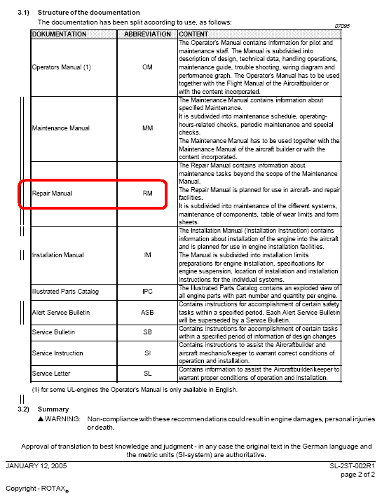

Nobody come forth yet with a SOFTcopy (.pdf) of the REPAIR manual, can someone please assist ???

Hi morph, thanks, a lot of good info there, but I am after this manual "Repair Manual" in soft copy??? The site also do not keep it.
Rudi

I still like someone to post the links to the repair manual, or email it to me if you have a softcopy, I'll host it. You really need it if attempting to strip these little motors as a backup reference.

Many thanks rudi for the close up shots of the clyd head that will be a big help to me.

If you find a PDF copy of the repair maunual please could you share it.
