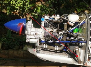

I am looking for this exhaust downpipe for a Rotax 582. The one that I currently have is too heavy and brakes in flight (too much vibration ?)

Make one from an old car shock absorber. It is very thin wall and light. End of problem. CKP still going fine? Would like to see her back as a taildragger though :lol:
