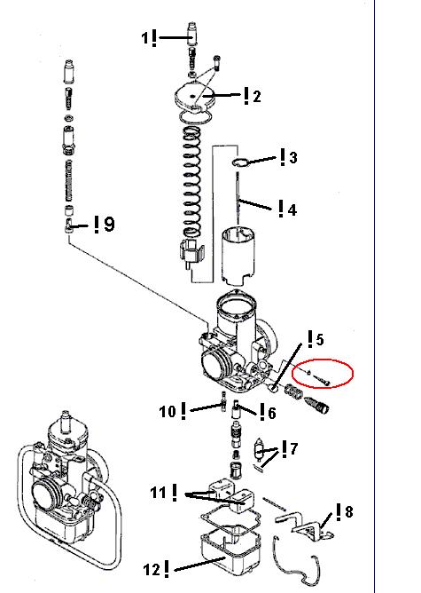

I would only worry if she has a tendency to cut out if you reduce throttle to idle. Other wise it sounds like a normal 2 stroke to me.
Just make sure your Idle airscrews are both at the same settings.. On the side of the carbs are the idle air screws. (See pic below) Screw them all the way in, then 1 whole turn out for a 582, and 1.5 for a 503
