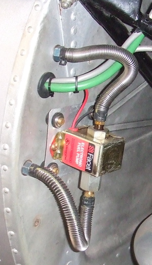

Facet pump fitted to a Aircoupe
Postby ZULU1 » Wed Feb 21, 2007 7:20 pm
Hows this I saw one fitted to a reconditioned 1946 Air coupe..
eish Zulu1
Facet pump.jpg (88.92 KiB) Viewed 3934 times
