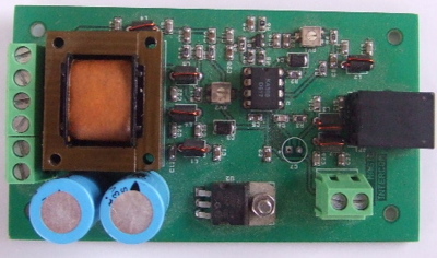

Whilst on the subject of line filters, I may add some further tests as we are doing some big Mil toys at present. The benefits of this forum are that we are all learning, I always listen to others comments.
Anyway I took some torroids and with my colleagues we went looking for a back to back test, over 20k they are awesome, but a wire choke below 10k will out perform line noise. However the torroid is better for rf suppression through the range. Each device has to be selected for specific frequencies. So we stay with our initial experience and use a combination of wire line chokes and rf beads (must get correct frequency). The best rf beads come with Icom mains chargers !! I use a Jonway scooter with all suppression devices removed for power and line tests, it blows headlight bulbs and sometimes peaks at 60 volts but does the job for me !!
i attach a pic of our military intercom board clearly showing a wire line choke, rf beads at specific points with a LM7805 and LM386
This really works well as it removes rf at specific points, mic amps etc. the unit illustrated is on a bus and can accept a high number of headsets and will accept three radios in.
